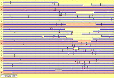

Hi,
Any help or advice appreciated as I am struggling with a internet connection that keeps going down.
Event log from router attached.
Brief history:
First issue occurred in mid-July, engineer came out fixed a fault - service resumed ok.
However since 30th July (confirmed by Plusnet support), my broadband connection has dropped multiple times, some are short 1-2minute blips, but I have had a few longer periods 2-4hours.
Now, I have had 2 further engineers in August, they see faults, fix faults (not sure on the specifics!) mainly changing socket covers and wiring - note I have used the same connection for 11years without issue.
Today I had a senior engineer come, who went and fixed an issue in the "cupboard" (I live in a block of flats), he said there is no issue with the line now, and if it happened again it was an issue elsewhere...
Within 2 hours of him leaving it happened again, but speeds have also dropped considerably. I'm at a loss at what could be causing it, I've looked at the logs and wondered if its related to the DCHP lease but I'm not technical in that way to understand.
I did have a tplink which was connected, but I turned that off a couple of days ago to see if that was the cause - issue still continues.
I don't have many devices which would be connecting.
I did have the older router, but got given a new Hub2 towards the end of July, to rule out router issues.
Package info - I have a basic broadband with phoneline, cannot get full fibre. The Engineers seem to keep connecting and disconnecting my phoneline when they come (I don't care which way if either works as I don't use it)
This are from speed tests today, but is pretty typical. I find the morning I get the best speeds. (Date / Time / download mbps / upload mbps)
28/08/2508:2415.80.29
 09:00
Disconnected by Engineer
 09:5329.37.86
 10:1627.56.71
 10:22299.02
 11:0426.76.75
 11:2325.49.22
 11:53Disconnected
 11:5428.66.88
 12:01Disconnected
 12:0228.51.94
 13:460.490
 14:204.80.1
 14:227.170.18
 15:024.76
0.09

Re: Intermittent Broadband connection - 3x engineer visits and unresolved
@mhouric
Its nothing to do with DHCP leases. Looking at that log , you've had 5 DSL drops already today!
Get back to Plusnet, tell them that the line is still dropping and the fault hasn't been fixed!

Thought I would add a follow up post in case anyone comes across this in future.
I turned off all my devices connecting to my Router and left my House for an afternoon and saw that the service was still dropping on the Router homepage - I then pushed for yet another Engineer to come visit.
Finally the 5th BT OpenReach Engineer, agreed to move my port and line in the cabinet after I pushed for it. Low and behold it solved my issue after over a month of drop-outs, inconsistent speeds and not getting 40/10.
My connection has been stable for 5 days now so I am pleased it is resolved.
