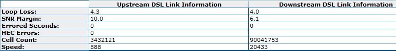

Since raising the fault, your line quality has improved significantly, which is why the fault ticket has been passed back to you.
Please see the attachment for your line stats. This information can be translated here: http://community.plus.net/library/broadband/broadband-faults-guide-our-testing/
I can't see why you'd be experiencing gaming issues, however your Interleaving is on.
Has anything changed with regards to your setup or wiring anywhere or had ANY new electrical devices fitted or started using Homeplugs?
