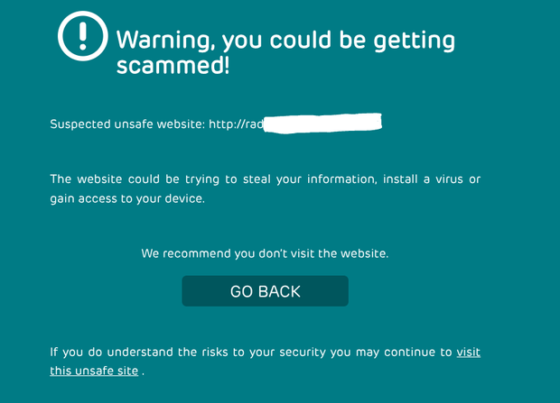

Reason I ask is that I was surprised to see this when attempting access over plain HTTP (this is from an EE broadband line): -
Before overriding that message, HTTPS requests would fail completely.

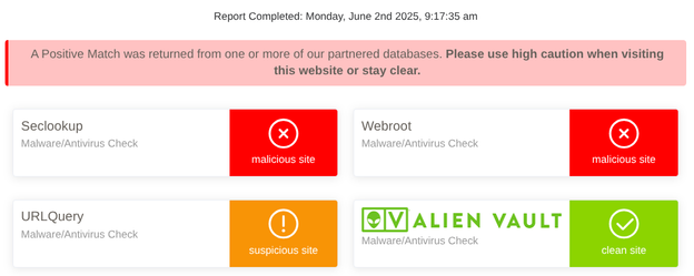

And a quick check of your domain name using a random reputation site (ssltrust.co.uk) from a Google search: -
Could it be that there are filters applied to the networks you are attempting access from that are blocking attempts because of the above? 🤔

And yes, my content is all hosted in my house and is safe from nasties. I assume that warning is due to another person using a different subdomain who's isn't safe from nasties.
