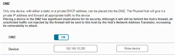

It is the billion device which goes in the Hub Two DMZ, if your billion is not using 192.168.1.0/24 network then nothing needs changing.
For the Billion router the device needs adding to the Hub Two DMZ; the setting is found in the Firewall. It looks like
The device must be allocated an IP Address by the Hub Two, you can use the IP Address or the device name. I would recommend device name, as IP Addresses can change if not fixed.
Are you still wanting to try Bridging Mode rather than putting the Billion in the DMZ?

Set if you wish to try the double NAT & DMZ suggestion then:-
On the 8800 , Add a WAN service selecting the Etherent port, set the type to IP over Ethernet. Check the 'obtain an IP address automatically' box (thats the DHCP bit!), uncheck the IPV6 Enable box. I think all the other settings can be left at the defaults.
Then proceed as suggested earlier, connect the WAN port to a LAN port on the Hub 2. The 8800 should then obtain a WAN IP address from the Hub 2. Then set the 8800 in the Hub 2 DMZ as shown by @Dan_the_Van earlier.
NB you'll probably want to disable the wifi on the Hub 2 to avoid interference with th 8800 wifi. Maybe @Dan_the_Van could kindly post the wifi configuration screen ?
