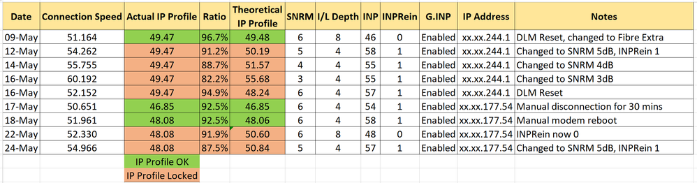

Anyway, I've updated my table with the current situation;
So I'm still on 6dB SNRM, but changed to retransmission low, INPRein 0. In my opinion it looks like the IP Profile has been locked again, this time to 48.08 as it should be more in the region of 50 with retransmission low. I'm therefore starting to wonder if the overall system logic has been changed to lock the IP Profile when DLM tries making improvements and once concluded, the IP Profile is then unlocked (this does give a consistent user throughput  experience during DLM activity), but I could be completely wrong!! More, do nothing, waiting game to see where I end up!.............

I agree with this post on TTB Forum over VDSL IP Profile by j0hn83
Retx High (High G.INP) gives an IP Profile roughly 91-92% of the sync speed.
So that matches what you are seeing now.
Retx Low gives an IP Profile that's exactly 96.69% of the sync speed.
It may only be exactly that figure on Broadcom chipset modems and may differ very slightly on other modems.
Also to add you won't upset the DLM if you leave 30 minutes between disconnecting and reconnecting. It doesn't even count that as a resync.
The DLM monitors lines using 15 minute bins. It's only if you disconnect and reconnect in the same 15 minute bin that it gets counted as 1 resync. So leaving it 30 minutes guarantees that it isn't counted as a resync.
**You are also allowed 5, 10 or 20 resyncs a day, depending on the DLM policy chosen by the ISP, before the DLM thinks there is a problem.
1 or 2 resyncs in a 24 hour period will have no negative consequences to any line.
**The DLM thresholds have changed a bit over the years and those figures may no longer be exact but they haven't (and almost certainly won't) change enough that a couple resyncs will make a difference.
In saying all that it is understandable to not want to upset the temperamental DLM.

Thank you @goldenfibre for the IP Profile info which I've used in my table to indicate when it's been locked / not tracking, the connection speed.
Thanks for raising the fault @Gandalf . I've updated my table with today's DLM activity which lowered the SNRM to 5dB with retransmission high. IP Profile still locked on 48.08. I hope BTO come back with an explanation for this locking/unlocking after a DLM reset or recognition of a fault they need to fix.

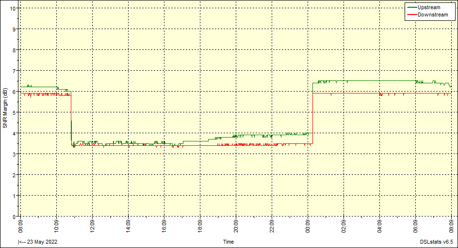

Hi @Champnet , yes, similar time each day but to be honest there is little SNRM drift throughout a 24hr period (the drop below is the DLM reboot to 5dB):
