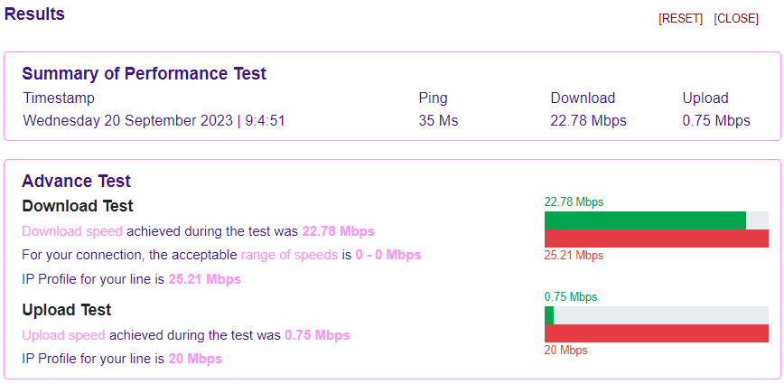

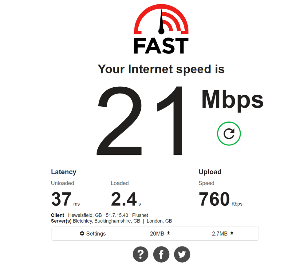

Right so I've run a few different test that I can from a few different sources, results are below.

@Roxiefrost your upload speed is VERY slow, can you post the router technical log/helpdesk information please, as @jab1 requested
