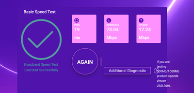

@Dan_the_Van would you mind checking the Btw test  for your observed speed ?

@Dan_the_Van thanks. I'm going to let @Gandalf explain the 66-73 estimate from an 80 Mb observed maximum speed then ?
Re: Hilariously dismal 'upgrade' offer
I would also be interested in the explanation for this.
As we live only 50 (cable) metres from the cabinet, our line also syncs at 80/20, (Max data rate approx 105/35), reliably - it stays connected for weeks on end, yet our estimated speed is also given as 66-73.
