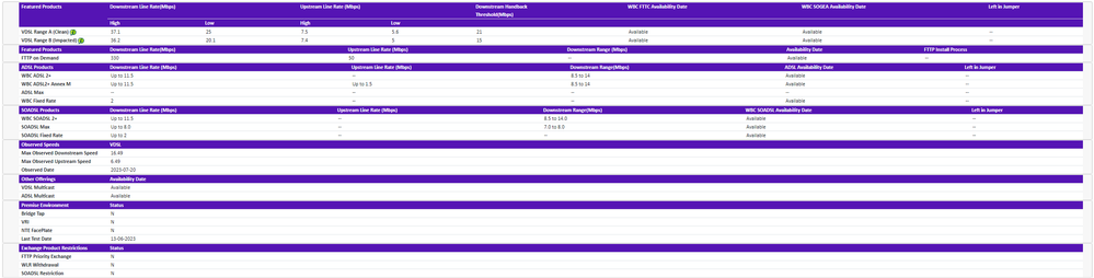

If you want help from the Community, can you post screen shots of the results from the following, please? https://www.broadbandchecker.btwholesale.com/#/ADSL  - ensuring your phone number is obscured. https://speedtest.btwholesale.com/ - the 'Additional Diagnostic' report would be useful, if you can get it to run.

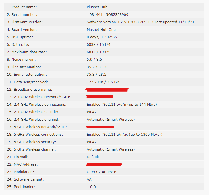

I've run the tests suggested - see attached. Not sure how to interpret any of this, but it seems to suggest to me my line's only capable of 15.94mpbs max?  I'm using my original Plusnet Hub One router which has always been plugged directly into the master socket. I don't have an actual telephone to check the line for noise as I'm profoundly deaf and haven't had any need for one for decades now!

@Gillrich1 Your connection is capable of much more - see the top line in the ...129 screenshot. If you wish for further guidance, I will post my 'help text', which should allow fellow Community members to advise.

Thanks for that. Assuming you don't intentionally turn off your Hub, I can see a problem straight away - you are losing xDSL connection, which points to an OpenReach network issue. Your upstream noise margin is raised - another pointer in that direction, and your attenuation figures are suspect as well.
