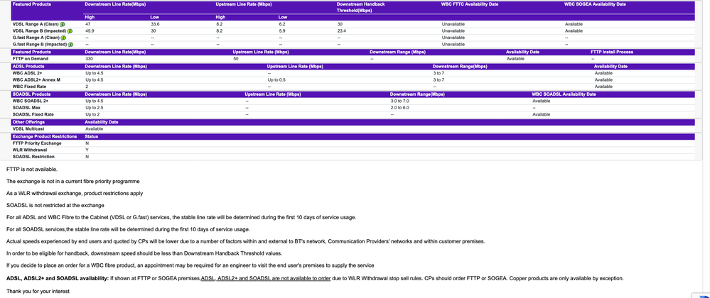

@doc_adeel Post the result from this link, as a screen shot, but obscure your address in the reply: BT Broadband - Address .

@doc_adeel  don't be assuming that the product called Fibre is similar to Full Fibre. Fibre (FTTC) is only a fibre optic connection to your local cabinet, the connection to your premises is then via a normal copper line. Full fibre(FTTP) requires a completely separate infrastructure to be installed by Openreach. True fibre optic cables are installed by Openreach, either to the poles if your connection is overhead, or new underground ducts, with only the short bit from pole or nearest underground chamber to be installed when a customer orders Full fibre. These cables connect to new aggregation points and go back to the exchange, they are not in any way connected to your local distribution cabinet. If your area hasn't been prepared for FTTP (which the checker confirms) then it isnt available from any ISP who uses Openreach. The checker will often show FTTP on Demand, which is where YOU can pay for a dedicated fibre connection to the nearest aggregation node but this usually costs many thousands of pounds and is really only intended for businesses.

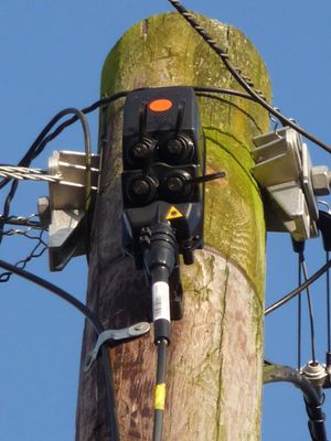

Does the pole your phone line connects to have something attached that looks like this.
This is a 4 port CBT (Consumer Block Terminal) for FTTP. You get larger sizes.
If it does, check neighbouring address (using the Address version of the Checker) to see what they say. If FTTP is available it shows as WBC FTTP in the left hand column.
