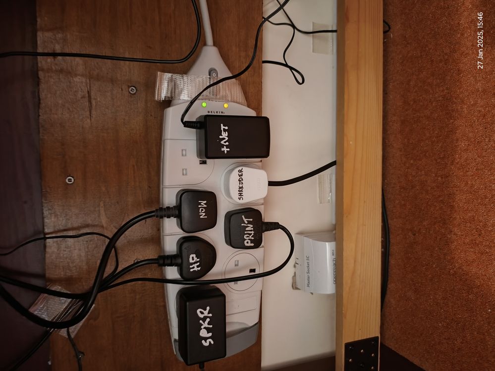

Latest info log and this what the cables look like now: -

Wow!! Al other things being equal (no router restart involved) that has made a marked difference - observed SNRM changed from 2.6dB to 4.2dB.
Whilst that might not seem like much, 3dB is a doubling of power, so a change of 1.6dB is significant, as indicated by the increase in maximum speed.
I suggest that (for the purpose of testing), it might be worth while looking at the router stats using the laptop on battery with ALL other stuff unplugged. If you see further rises in observed SNRM, something else is also pear-shaped!
Can the VDSL cable be routed away from the power block? It looks as though it is running up behind it.
This is moving in the right direction. If unplugging more stiff shows an improvement, the shielded RJ11 cable I referenced earlier might be useful.

I moved the DSL cable from behind the power block as much as I could but there are other cables behind the desk and the cable runs across two power cables. One to my HP PC and one to the monitor. Not running in parallel but crossing them. Relocating the hub to avoid this is not possible at this time.
Unfortunately this meant unplugging the DSL cable from the twice so there are two more 'Link Down' 'Link up' events and a new Info log.

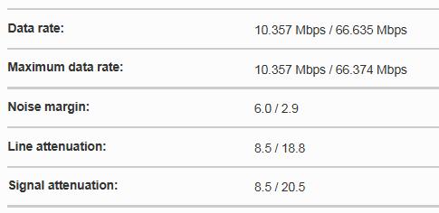

Re: Frequent dropouts 25th Jan 2025
27-01-2025 4:16 PM
27-01-2025 4:19 PM - edited 27-01-2025 4:27 PM
Actual and max data rates being the same is good news - at least there has been no change in noise levels since the reconnection. You might have fixed this!!! ![]()
Your line and signal attenuation are better than mine and I am running at 72.4mbps ... so you might see further improvement if the line remains stable.

Over 48 hours now since @Marsh ordered my NGA line stability profile to be changed from 'Speed' to 'Standard' so I wonder if it has now been completed?
Currently I see the Noise Margin is down to 2.9. See photo. Does this imply the change to 'Standard' has not yet happened?
08:10 today - Speed test showed 58.99 Mbps download and 9.69 Mbps upload.
I am very happy with this if the change to 'Standard' has been completed since it means good speed as well as stability.
In conjunction with rearranging cabling and removing as much electrical interference from local PSUs I hope the reliability will improve from now on and I will report on this in about a month.

I suspect that you’ve fixed the issue by creating separation between the PSUs and the router cable. If it now remains stable, circa 3dB will be fine and offer the best in sync speed. Error rate (without actually disconnecting) could be a different matter.
