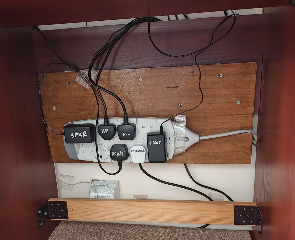

Thanks for the pointer re there is still some interference. There is one more thing that I can do (tomorrow) and that is to reroute the DSL cable.
It currently goes to the right of the master socket taking it closer to the Belkin 8-way power adapter before rising up behind it, where there are power cables it gets entangled with. These power cables are for my HP desktop pc, Benq monitor, Epson printer, 30w sound bar and the Hub Two.
I intend to route it to the left of the master socket taking it away from the Belkin 8-way power adapter before rising up to the Hub Two on my desk above. There will then only be the printer and Hub power cables that it may come close to so should be less RFI.

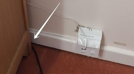

I have now rerouted the DSL cable away from all power sources except for the printer power supply cable that crosses it at one cross over point. This is unavoidable.
I was unable to do those tests you suggested because I don't have the correct cables or DSL filters. I got rid of the filters when I had the new master socket fitted.
The DSL cable is firmly taped into place at the master socket so it can't move but the master socket itself is still a possible suspect since I've isolated the DSL cable from RFI as much as I can.
I'll leave things a week to settle down/stabilise again and report back then.
Before rerouting DSL cable.pngAfter rerouting DSL cable.pngRerouted DSL cable1.jpgRerouted DSL cable2.jpg

I just realised that I could also move the 8-way Belkin power adapter to the right by 10cm taking it further away from the DSL cable so I may do that as well if you think it will help.

Compared to post #7 it would appear that your efforts have delivered a marked improvement in connection speed. You now need to watch for connection stability. If you get disconnects try to take note of what you were doing at the time - printing / shredding / waking up the laptop. Think about anything which might give rise to a change in electrical load.
Something being and remaining powered up does not infer constant loading / current draw. My worst case was CCTV IR illuminators - come dusk they would start drawing current and push the PSU into overload … crippling the ADSL connection.

FYI - I have moved the 8-way Belkin power adapter 10cm to the right so that's all I can do for now. I'll monitor the Hub Two stats over the next week and hope for no more dropouts.

Have you traced the entire length of the incoming telephone cable to where it enters the house ?
and ensured that there aren't nearby electrical devices anywhere along the route on either side of the wall(s).
