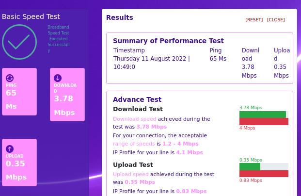

ADSL usually around 17Mbps. Suddenly it dropped. Last few days around 3.7
Test says profile speed is 4.1
(Had line checked and engineer while back and all was well till now.)
Line is quiet.
Ethernet speedtests / router below

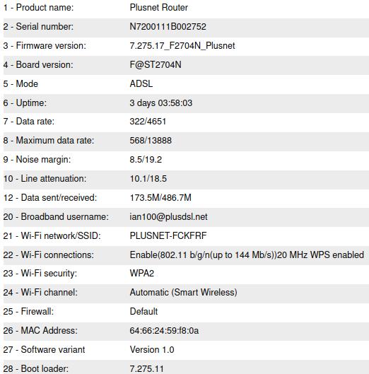

@IanSn Is your D/S noise margin usually that high? I suspect something is wrong - you've only had this DSL connection for 3 days 4hours.

What does the following say for your line. Post a screen image without your phone number.

@IanSn  You could try a single reboot of the router (power off and on again)  to see if the downstream SNRM comes down to a sensible level, although there may well be a line fault as the upstream stats also look to be very poor. You will probably have to report a speed fault.

Uptime date is exact to a powercut. Lasted 1 to 2 mins.
This is stats from around June so, yes, its different! -
7 - Data rate: 944/22191
8 - Maximum data rate: 1196/24552
9 - Noise margin: 5.7/5.0
10 - Line attenuation: 7.7/15.5

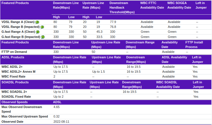

@bmc looking at the attenuation figures - and the  BT checker above, the OP is clearly close to the exchange/cab.

Can see the cab from my window, exchange is just down the road!

If you ran the speed test via VPN, that could have implications, but the 'observed speed' on the BTW report suggests that it did not have any significant impact. NEVER use VPNs when carrying out any tests/investigations.
