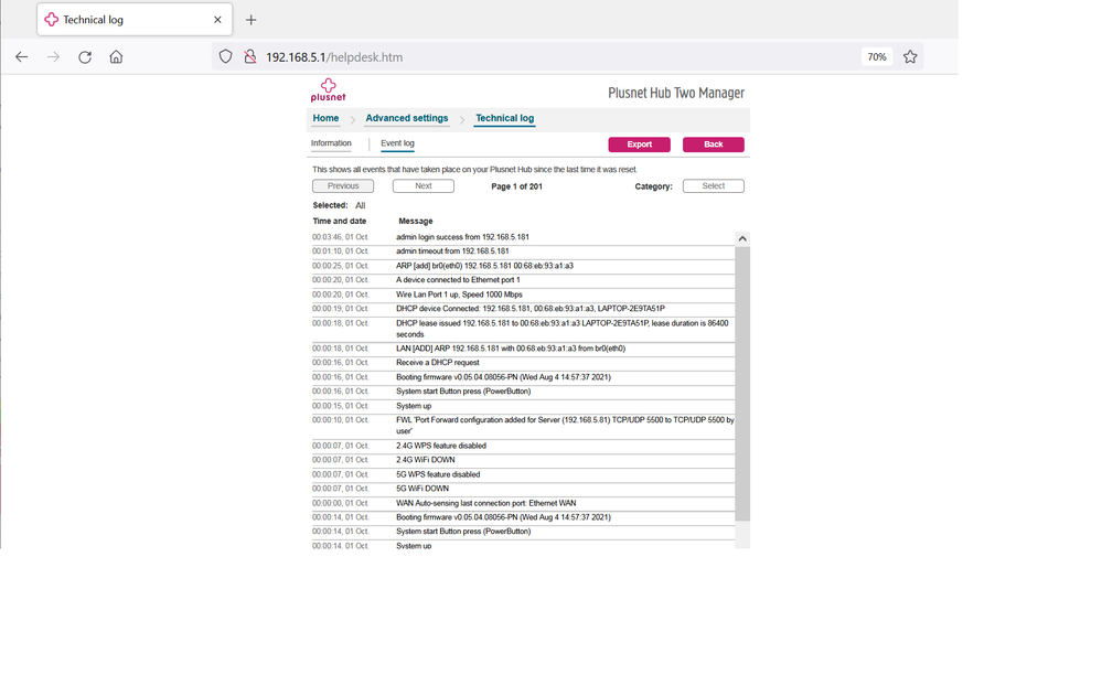

@Pauline_S If you have a PN Hub2, can you navigate to the page in the screenshot, below, click the 'Export' button there, and attach the resulting .csv file to a post? I'll get back to you this afternoon or evening, but I'm not at the laptop much this afternoon.

@Pauline_S Thanks for that . Unfortunately, it is not quite the correct file.When you have that page open, click on 'Technical log' at the top, then 'Event log' lower dow, until you get the type of data shown in the screenshot, and then export that file, please.

Re: Experiencing frequent loss of fibre broadband
11-08-2024 3:54 PM - edited 11-08-2024 3:55 PM
Pauline, thanks for that. It confirms what I suspected - from around 8PM on the 9th, a fault has developed which causing the DSL to drop with alarming regularity. Report a broadband fault via: https://www.plus.net/help/report-a-problem/ , and if they come back and say you haven't got one, as I suspect they will, let us know as soon as possible.

OK, @Pauline_S . It is just that on a quick glance through that event log I spotted a couple of things that made me wonder if it was a failing Hub, but in that case, it shouldn't be.
