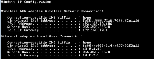

I have just reloaded my guest Win 7 on my vbox system, an ipconfig reveals, with no cable connected.
This what you should see with a network cable connected and the wifi adapter paired to a wireless network
HTH.
