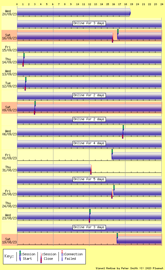

@penfold - It's looking stable for myside too. Have a look here @ http://visualradius.plus.net/visualradius/generated/image16952317992218.png. Let me know if you have more dropouts.
@penfold
Looking at the radius log I would hold back on posting the event log, the 1 am drops are most likely a DLM reset

Thanks all. Looking at the logs, it seems DLM moved me to a 3db profile 14th sept. I will keep an eye on it. As an aside the blank parts of the radios are where I had taken the router offline for decorating purposes. @Dan_the_Van why would the DLM be resetting and what does that mean.
