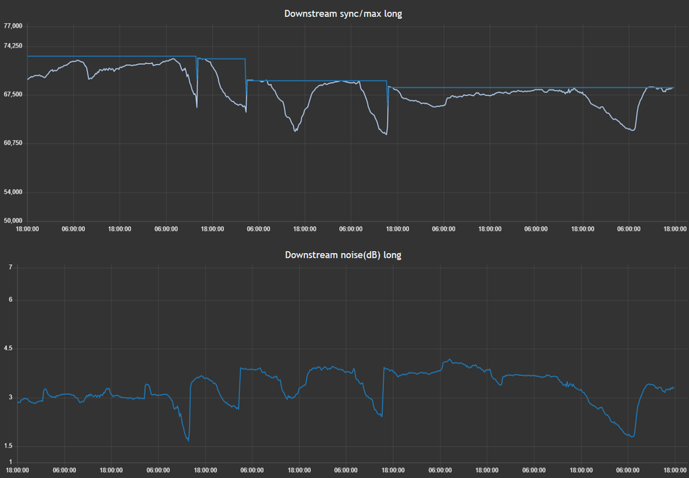

My FTTC line sync is normally around 73Mbps, seems stable to use and generally get a good throughput in the 60s Mbps.
Sometimes though, the speeds drop due presumably to some change in line conditions, but I'm not sure what the problem might be? Here is a 7 day graph from my router showing actual sync speed and "max sync speed", along with the noise margin - you can see DLM resyncing the line at progressively lower speeds over the week, then at some point it will go back up. Synced at 68.523 right now but probably be back to 72/73 next week. Is this just normal or am I on dodgy copper?Huh

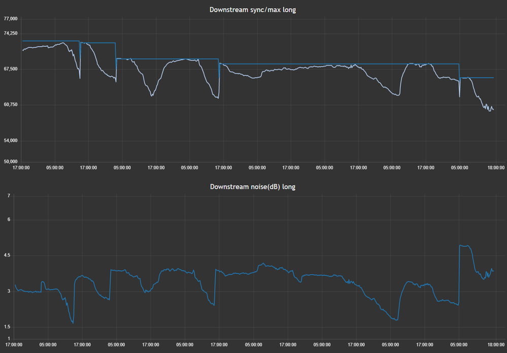

It's still dropping actually - resynced at 5am to 65.941. Updated graph below, I'm away for a few days after tomorrow so it's not a big issue right now, hopefully it will have recovered by the time I get back

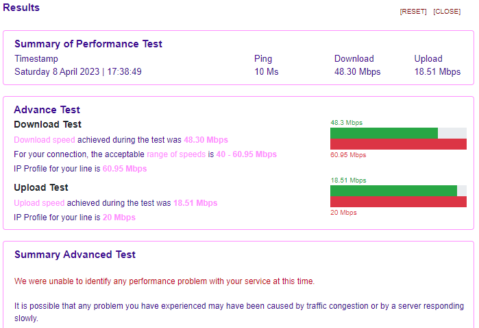

BT Wholesale speed tests (over ethernet direct into the router) returning between 49-54Mbps (which is below the "Minimum Guaranteed Speed of 54.6Mbps we promised you"), and the results of the BT advanced test is below

It has dropped a bit further, now synced at 65063 which is over 10Mbps lower than I have seen at its highest - I haven't seen it reconnect this week other than due to the electricity going off for a while.
I get between 50-54 Mbps download speed where I have previously seen high 60s.
