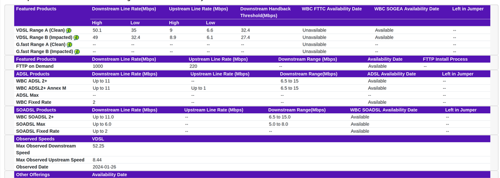

@Baldrick1 - the old PN router got me significantly lower connect speeds than the VR600  - it had originally been connecting at 48M+ but had got down to the high 30s and wouldn't go any higher and seemed incapable of getting the SNR close to 3.. The VR600 connects at over 50 each and every time with a SNR of between 3.1 and 3.3 and I;m right on the upper limits fir the line now - and I''m a long way from the cabinet (approx 800 Metres)
