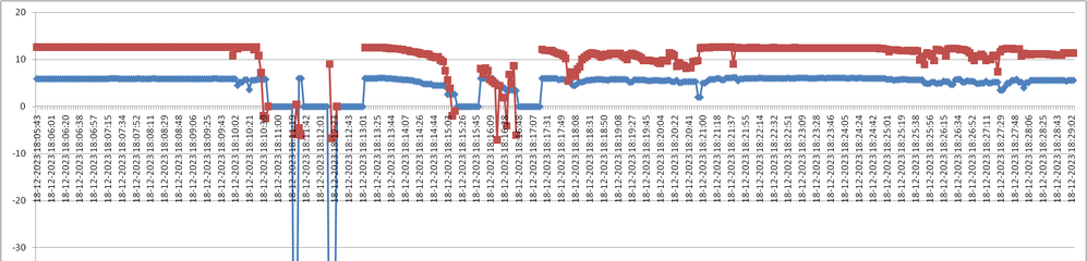

Here's a graph of SNR today at 6:05pm to 6:29pm:
Shaky, isn't it. Disconnects happened at negative SNR. During which, I did not hear any noise on the phone. No faint background noise either.
But I have the modem connected to a long line. Could that be the cause? I've now moved the phone to the end of this long line to find out. Unlikely though, I had this same problem on an exterior extension line.
My best guess is just the usual damp problem but that should cause noise on the phone, right? Else, it could be a DSL infrastructure.problem. A previous engineer visit did switch to a "second line".
