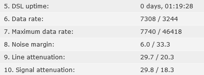

I connected the phone directly to the master socket and I got the same faint background noise.
Modem stats the same after reconnecting:
The front panel is very dead, so reconnecting it is not an option. The original source of the extreme noise.

You can buy new front panels for very little from, for instance, Amazon. As stated previously, the fault is somewhere in the Openreach infrastructure, most likely in the copper line from the Fibre box to your home, which will need OR to rectify.

@willcutforth With respect, until the cause of that horrendously high D/S SNR is eliminated, I doubt a DLM reset will achieve any lasting results?

@jab1  Wouldn't it be reasonable to say that on such a chronically banded line the extremely low speed cap is the direct cause of the ridiculous SNRM figure. A DLM reset is needed to get the line into a more normal state so it can be monitored effectively. At present the massive SNRM is masking any noise problems affecting the line.
