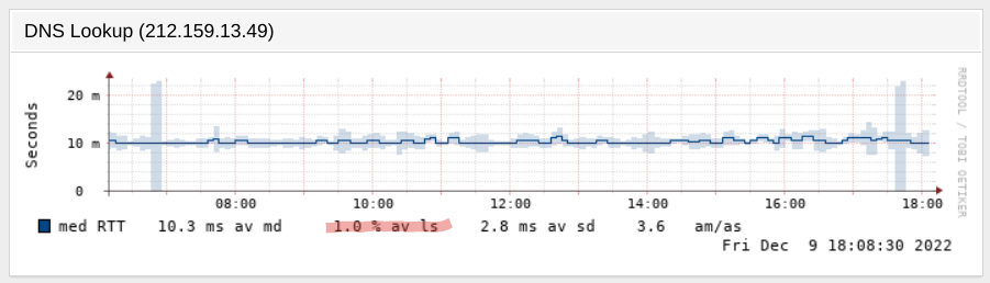

@seebee - I do see similar on my own monitoring, however it seems to have been a relatively new development (last few months). There is a larger piece of work going on behind the scenes that I expect will make the issue 'go away', however I can see if somebody can take a look in the interim.
Remind me next week.
Edit: e.g. this is 12 DNS requests every 300s on my own network: -

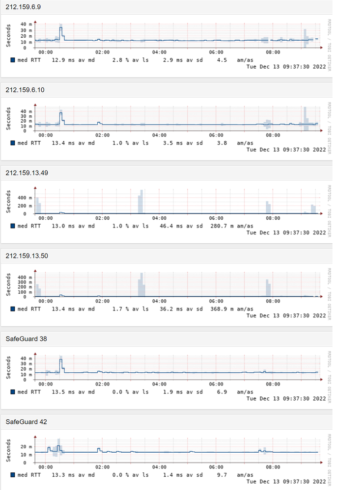

I use smokeping to monitor pings, but I'd never tried it with DNS lookups, so I had a go and I saw overnight between 1.0% and 2.8% loss with the 4 normal DNS, and zero with the 2 SafeGuard ones.
(Raspberry Pi3b, Ethernet, ADSL, IP in 51.9.x.x)

@seebee - thanks, now raised internally under ref: IMT-8230.
Edit: to clarify, I also have a direct comparison in my own monitoring and my observations match @seebee's - started around September time.

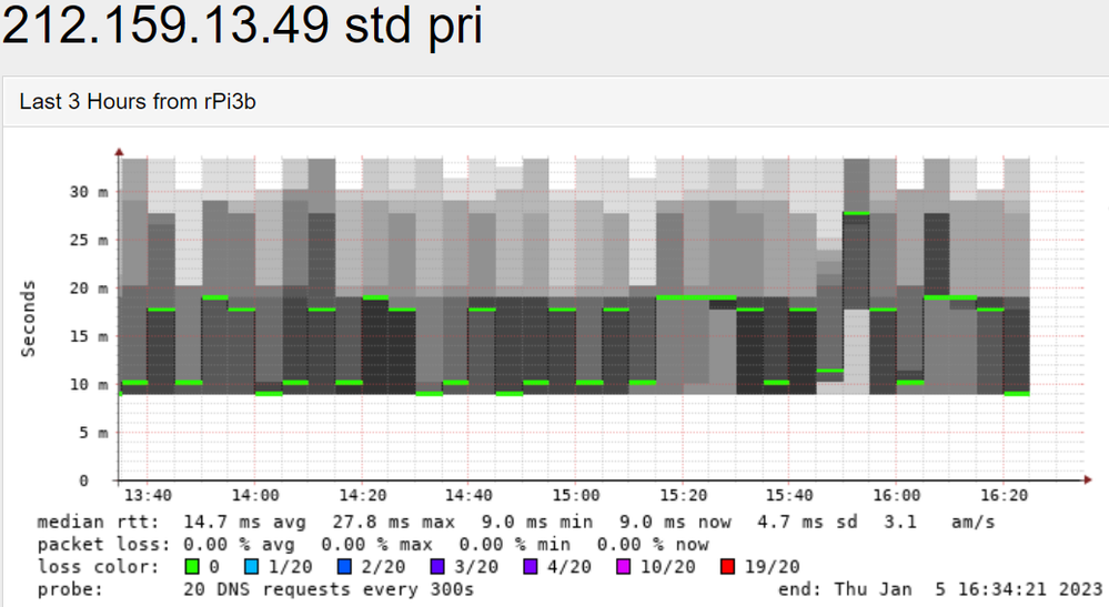

On a tangent - the SD card in my Raspberry Pi failed so I rebuilt it over Xmas. "dig" (which smokeping calls) is giving me results SOMETIMES of 9ms DNS resolution time, which I'd think impossible as I've always seen my ADSL line have an inherent delay of about 13ms (eg pinging gstatic.com or 1.1.1.1 etc).
I'd be tempted to say its something in the recent version of the rPi build. Don't suppose you see "too short" DNS times in your monitoring?
eg
$ dig @212.159.13.49 gstatic.com.
; <<>> DiG 9.16.33-Raspbian <<>> @212.159.13.49 gstatic.com.
gstatic.com. 68 IN A 216.58.212.195
;; Query time: 9 msec
;; SERVER: 212.159.13.49#53(212.159.13.49)
then
gstatic.com. 180 IN A 142.250.187.195
;; Query time: 19 msec
yet
$ ping -c 100 -q 212.159.13.49
PING 212.159.13.49 (212.159.13.49) 56(84) bytes of data.
--- 212.159.13.49 ping statistics ---
100 packets transmitted, 100 received, 0% packet loss, time 99155ms
rtt min/avg/max/mdev = 12.278/13.911/50.144/3.969 ms
So the smokeping charts are a bit "castellated"!
Zero loss though, which is the important bit.
