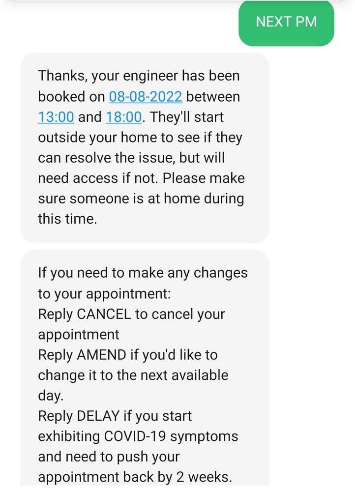

I can see the engineer looks to still be working to resolve this for you, so let us know how the visit went once they've gone.
Re: Constantly disconnections all day. Please help
08-08-2022 5:52 PM - edited 08-08-2022 5:56 PM
Thank you . Well the openreach engineer couldn't find any faults *head scratcher* I'll see if it happens again. Your bot said there's fault found on the line but the engineer couldn't find it. Only seems to happen during the night to 7am. He said give it couple of days and contact me.
