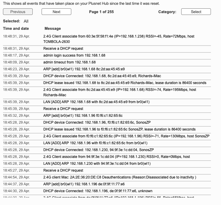

Ok so it happened at 18:54 - speedScreenshot 2024-04-29 at 18.56.56.pngScreenshot 2024-04-29 at 18.56.40.png

sorry, i was a little hasty in send that last post.  it happened again at 18:54, the speed test failed to connect and there's nothing in the logs.

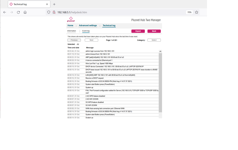

OK. Looks like you have a lot of wireless devices connecting/disconnecting, which swamps the log. Are you sure you have a Hub2 - if so, when you are on the page in the screenshot below, click the 'Export' tab and attach it to a post - it won't paste into the reply.

Sorry - forgot to add the image! Embarrassed
richardt

it's definitely a Hub 2 it says on the back.  Log attached - I did a factory reset of the router at 19:11 as suggested by tech support.

Sorry, your screenshot in post #16 was a little confusing as you had chopped the top, but no worries, you have posted what I needed now.
I can't see many xDSL drops, but your Wi-Fi connected devices seem to be dropping in and out a lot - how many have you got, and are they moving around the house a lot?
