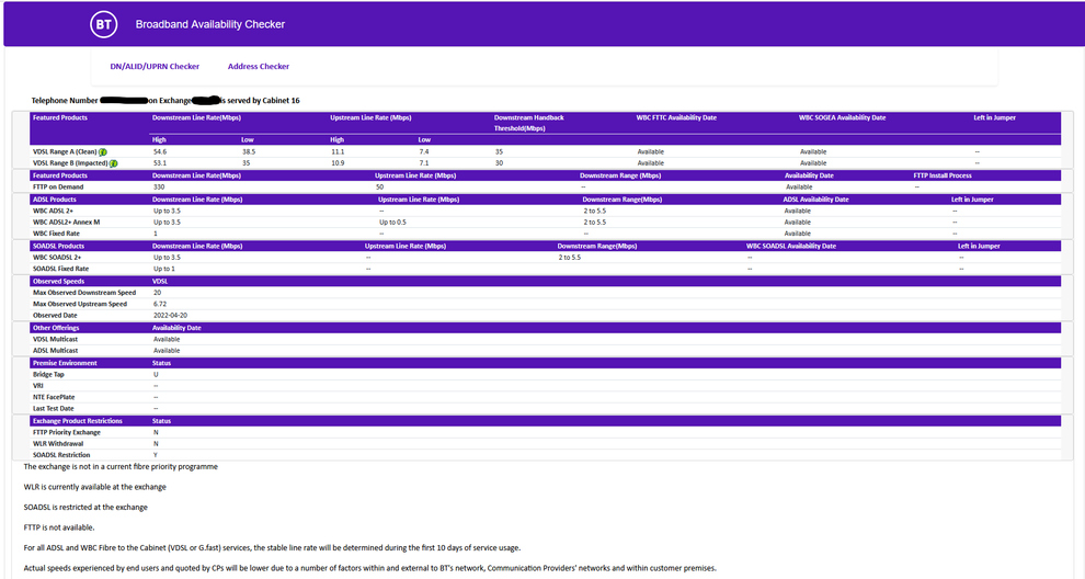

Cheers for the links. Here's the one for the BT Broadband site and the downloaded reported from the Wholesale performance tester is in the first post.

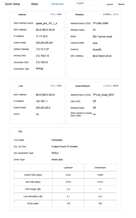

And here's a screenshot from the modem page

I've previously done the Quiet Line Test with the first engineer and everything was fine, so it does seem to be broadband based. Annoyingly we don't have a phone line anymore (Gen Y for you!) so I can't test it right now but 1-2 months ago there was no issue.
Thanks for the help!

OK @JJS That is definitely not good - I would report a fault at https://faults.plus.net . Note that a line reporting OK 1-2 months ago could develop a fault minutes later - a basic phone is an essential basic tool until everyone is on FTTP.

Hiya @JJS, thanks for getting in touch. I'm really sorry that you're having some issues with your speed and that they have dropped again since your engineer visit earlier in the year. I'd like to do what I can to help here!
I've tested your line and it looks like this is 'banded' and so I have first requested for this to be lifted and have updated your fault ticket here with further info: https://www.plus.net/wizard/?p=view_question&id=223750206
This can take 3 working days for it to update once we raise it to our suppliers.
Let us know how things go. I'm really sorry for the hassle this causes in the meantime.
