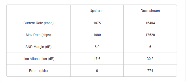

Azagoth
Posts: 661
Thanks: 5
Registered: ‎01-08-2007
Re: Connection dropped and now speed is so slow
Whatever you did seems to have increased my speed, it's now back to a decent enough speed.

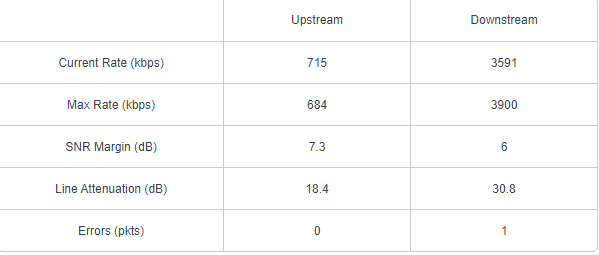

@Gandalf @SammyM The speed has dropped again.  It's been perfectly stable at 1.5-1.6MB for a month, but I got back from work today and it's dropped to this.
5c2NbwU
Nothing in the house or on the PC/router has been changed and the phoneline is quiet.  Can you give it another kick up the 'arris (SNR reset) like you did previously please?

@Azagoth Looking at those figures, you are connected at 3.59Mb/s, not far off the max. Are you still on an ADSL connection?
Why do you see this as a 'drop'?

Hi @Azagoth, our logs are showing that the connection is dropping out every few minutes so we'll need to get to the bottom of that issue for you, an SNR reset at this stage would only make that worse and in turn lower speeds as DLM takes effect.
Can you try following the checks here as your next step please?
https://www.plus.net/help/broadband/connection-troubleshooting/

Looking at the difference in the stats between posts #9 and #11 would lead me to suspect that there is REIN present in the locality.  Remember that the SNRM is a MARGIN metric, not an absolute measure.  It is the level of the usable signal ABOVE the background noise.  The fact that both sets of figures report a 6dB margin with markedly different speeds imply that the background noise was different at the times the stats were captured.
This scenario needs dynamic monitoring of the line stats.  Which router are you using?  Router Stats is a handing free program (see the link below) which works well with many routers, but not all routers.  There is a special version for the BTHH5a which works well with the Plusnet Hub One.  I recommend a sample interval of 10 seconds.  You only need to worry about the SNRM plot.  I expect that it will be a tad crazy like the example below...
That shows a line suffering from a great deal of REIN giving rise to repeated disconnections.
Following the stats in post #11 you should expect to see that the connection remains stable, but slow, with the SNRM being significantly elevated if the intermittent (electrical) noise has abated.
Check the phone line for noise regularly - bad joints giving rise to intermittent noise will give rise to the exact issues you appear to be having.  Note that the act of testing a line, or just using it can "fix" the issue for a short period of time.
