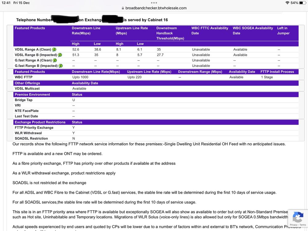

Can you post a screenshot of the result from this site (obscuring your phone number) https://www.broadbandchecker.btwholesale.com/#/ADSL and then we can advise further?

@carolynbell1 the good news is that Full Fibre ( shown as WBC FTTP ) is available to you.
Your exchange is showing as 'Fibre priority' which means that if you either upgrade (with your existing ISP) or change ISP then you can ONLY change to a Full fibre product.
A Full fibre installation will run a new cable from the pole to your premises ( and may remove the existing cable ) and a new box , called an ONT (Optical newtowrk termination) will be installed inside. There's a good guide here https://www.openreach.com/help-and-support/full-fibre-broadband-installation-checklist. The ONT will need to be within 1m of a mains socket and is connected to your router with an ethernet cable
