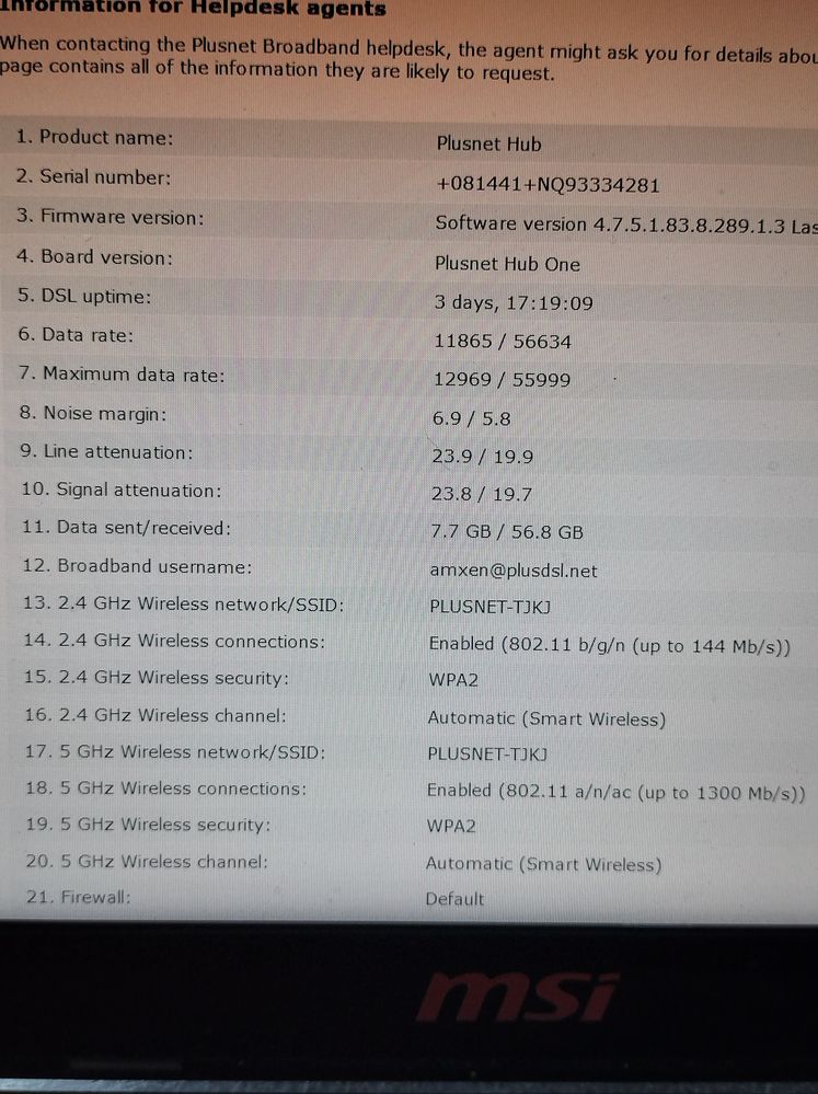

On the Hub One Home page http://192.168.1.254 under My Services is your Broadband username being displayed or setup@plusdsl.net?
If setup@ you need to Navigate to Settings >Broadband (you need to disconnect before changing the username) enter your details. <yourusername>@plusdsl.net and your password.
Navigate from the Home Screen to Troubleshooting > Helpdesk lines 5 to 11 are your line stats, what are they?
Are you changing any of the default settings on your Hub? If so what are they?

iv just looked and it is set to amxen@plusdsl.net . iv not changed it at any time but the Plusnet Access Control: is saying Disabled . dont know if that makes any difference
