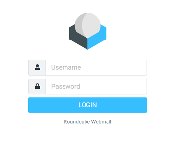

No issue here using Plusnet default DNS servers.
Make a note of your public IP address & then power the router down for a couple of minutes. When it reboots, check the IP address has changed & try again.
