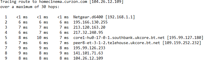

Slightly different route:

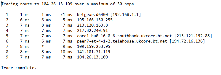

@Dan_the_Van  Using the IP address gives another slightly different route :
