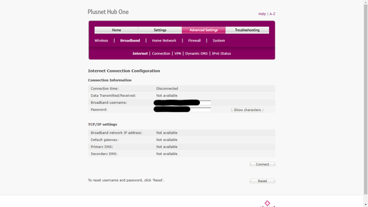

Hello, thank you very much for replying. I have gone onto the broadband page as you suggested and entered my ...@plusdsl.net username and my password and then clicked 'connect' in the bottom right corner. Nothing really happens then besides the page refreshing to the same state with everything saying 'not available' or 'disconnected'. I know the details are correct because when I enter them incorrectly, it tells me that they're in correct.Wifi.png
Is there something I'm doing wrong or something else I need to do now, and if so would you be able to guide me through that as well?

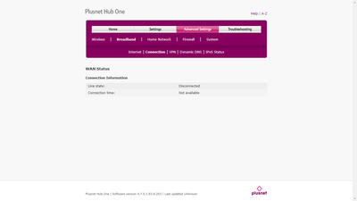

I've taken some more screenshots a long the way to see if any of them are of any help to anyone at all.
This is what appears when I first connect to the internet:
This is what appears when I first connect to the internet.This is what appears when I first connect to the internet.
And this is a couple of hub manager screenshots if they tell you anything?
Thank you very much for your time again.

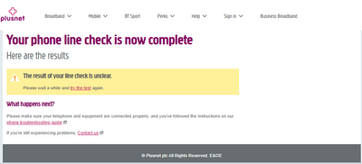

I tried the factory reset and still got the same results. I have plugged my landline into both the microfilter and directly into the master socket and get no dial tone so I can only assume that the issue is with the phone line itself rather than the broadband.
I attempted to use the trouble-shooter and keep getting this result:
I have also tried calling the landline number from my mobile a couple of times and both times the same local business picks up, so I'm wondering if there's a crossed line issue somewhere that's having some affect?
Sorry for the bother so far, I can't help but feel like I'm missing something obvious so I'm happy to give as much more information as you need.
