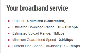

Here are contract details from plusnet website

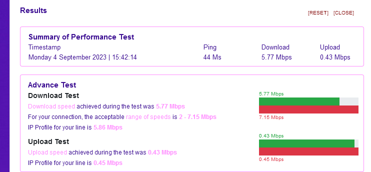

Here is a result from the BT Wholesale speedtest site

The Plusnet broadband service info is basically useless, it is all estimated and plainly wrong. The current line speed is not an actual speed but a Plusnet profile which is supposed to track the BT IP profile which it isn't so it's also wrong.
Looking at the maximum range values in the BT Advanced Test of 7.15 Mbps and 0.45 Mbps those values strike me as close to the maximum speeds for an ADSL1 service so another oddity.

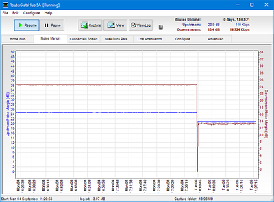

Thanks for doing this reset. The noise margin levels are much reduced although still not at the low levels I saw before:

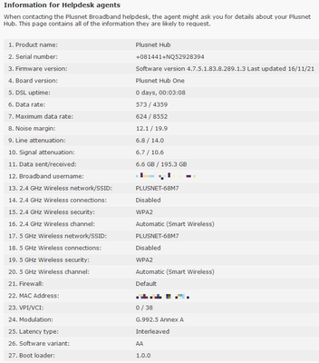

Here is the Hub One Helpdesk display:
The Modulation suggests it's set for ADSL2

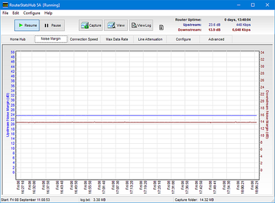

I attach RouterStatsHub output for today after the line reset has been given a couple of days. The line speeds still seem pretty slow. I haven't yet started a fault report. Should I go ahead and do that?

@simonc2 I don't know about the event log - it is full of blocked attempts, but the Help Desk shot is somewhat concerning - your DSL uptime is horribly low and the D/S SNR is horribly high - I suspect a fault in the OR network.

@simonc2 The screenshot at 6.08PM shows your SNR margins, not speed, and they are horrible.
