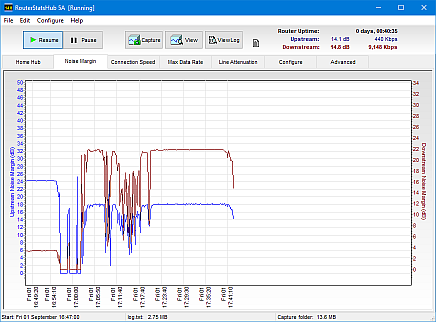

I don't know if it's going to be a problem but the connection has been unstable this afternoon. I'll keep monitoring it with RouterStatsHub.
I don't use a mobile phone so I'll have to borrow one to send the text message.

@simonc2 wrote:
@jab1
Regards
Simon
Simon - that is a definite problem - looks to me like an OR network failure, but let us know the result of your report.

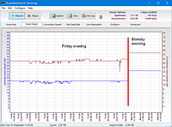

Thanks fo everyone who offered advice, especially for the link to the online fault reporting page.

@simonc2 Those noise margin figures from this morning are horrible - which Hub/router are you using?

It's a Hub One from plusnet.
Looking back at previous issues the upstream noise margin has been at 24dB since April this year when they last fixed a fault I reported.
Why-does-plusnet-keep-messing-up-my-broadband-connection
The downstream noise margin after the fix in April was about 4dB however.
At that time I received a message from plusnet saying "We have asked our wholesale broadband suppliers to turn interleaving on, on your phone line to try and fix your current broadband problem." so that was evidently the fix they applied. I noticed the noise margineseems to be more elevated after that, but the broadband connection was stable (until last Friday).
I'm slightly confused about the term "noise margin" - I instinctively thought this represented the margin between the signal and the noise, so a large number meant the noise was very small compared to the signal.
Simon
It does but unless your line is running right at the top of your contracted speed the higher the margin the slower your connection speed.
