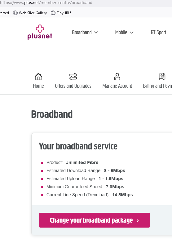

I'm puzzled by this:
My Plusnet account says:
and if I click on "Change your broadband package", I'm told:
Just my standard 6-monthly grumble about our speed .... mainly the part where Plusnet say I'm getting 14.5Mbps.

@JohnofYork Basically the speeds shown on your account are not actual speeds they are estimates apart from current line speed which is not a speed at all but an internal Plusnet profile used to control speeds on connections with a Static WAN IP address, it has no effect on dynamic IP's.

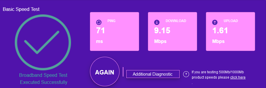

However it is set by the BT IP profile which suggests you should be getting better speeds, what does the BT Additional Diagnostic give you for the IP profile ( The box on the Basic Speed Test Result) and what is the modem/router downstream sync speed. If you can't get this from the modem (needs to be unlocked) the BT Checker should show it in the Observed Speeds section. Link to checker .... https://www.broadbandchecker.btwholesale.com/#/ADSL

Thanks.
The BT Additional Diagnostic comes up with this:
The Observed Speeds from Broadbandchecker give:
Max Observed Downstream Speed 10.42
Max Observed Upstream Speed 1.45
Observed Date 2022-11-29
Don't seem to be able to find the downstream sync speed on my Asus RT-N66U router.

@JohnofYork Sorry I have not replied earlier but have been busy with Christmas stuff. The BT test didn't give us the IP profile so that doesn't help. You won't be able to get the line stats from the router, the Openreach modem does the actual connection and the router doesn't know the speeds. You could put the Plusnet Hub1 back and get the stats from the Help Desk diagnostics tab (I think, I don't use ISP supplied routers). The observed speeds are bit out of date but probably similar to what you are getting now.
You say in your other thread that the checker estimates are much higher speeds than you have ever achieved, this is a bit odd as the checker is generally fairly accurate. I wouldn't be happy if I didn't get close to the maximum predicted speed. The high current line speed is also strange as it suggests that at some time speeds have been higher.
The modem/router stats would be useful to see if you should be getting better speeds.

There is a deal of confusion herein.  Data speeds are not the same as sync speed and if there is a speed concern to be examined, the focus needs to be sync speed.
The "current speed" reported by the Plusnet portal refers to sync speed.  What are the line metrics reported by the router?
