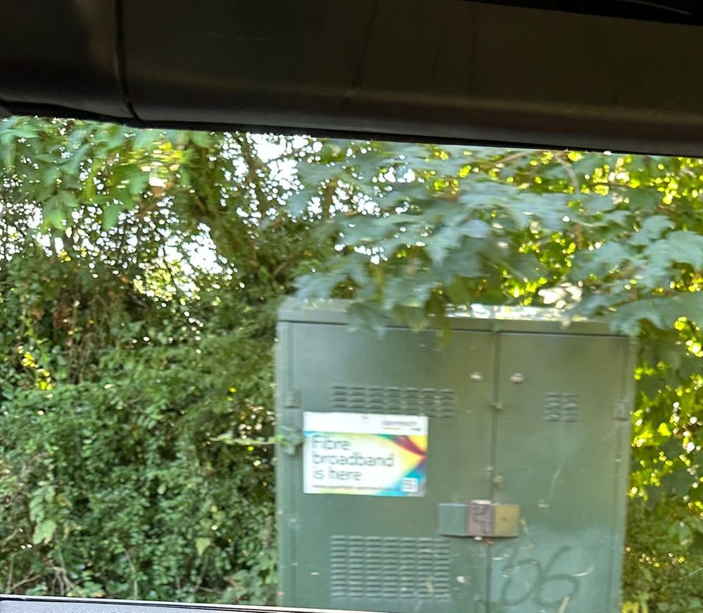

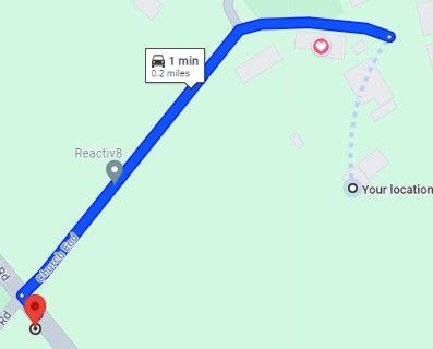

@jab1 There is a cabinet 0.2miles away from my house, I'm assuming that's the exchange you are talking about?

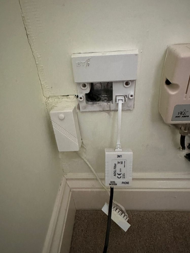

@MisterW I am not sure what a "master socket" is, is it the photo below? The router is connected to this.

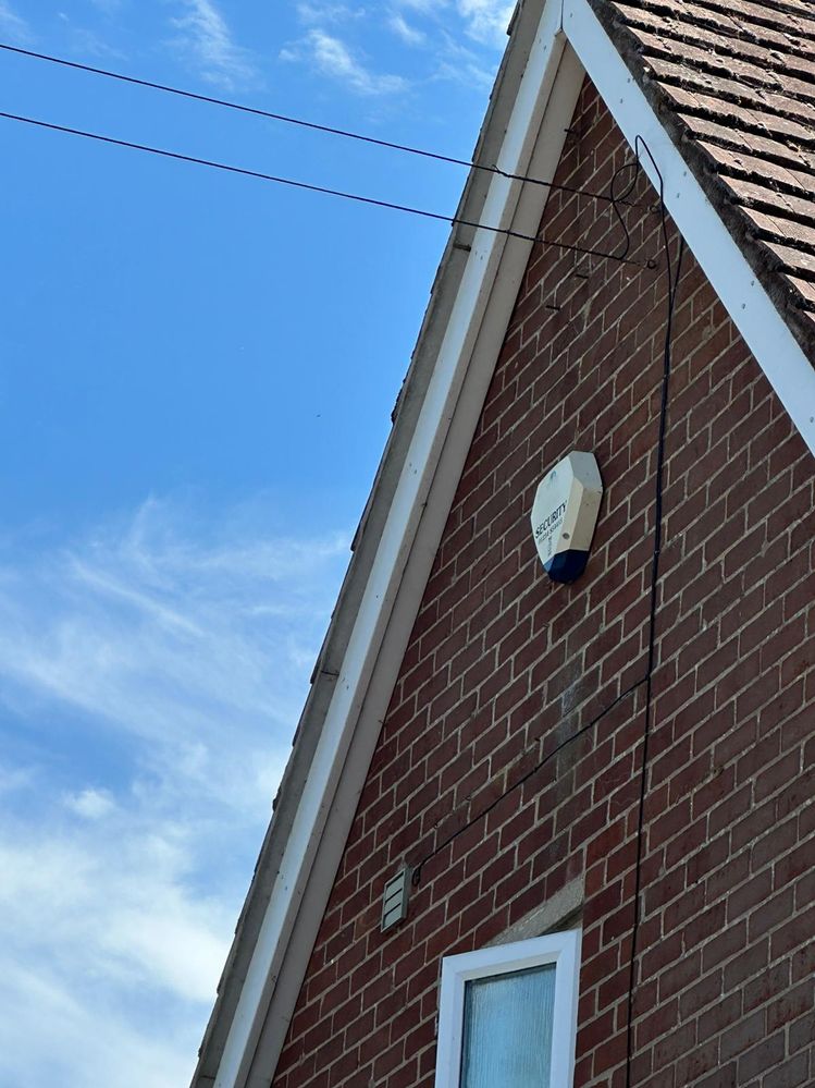

I moved to this house about a year ago, and the previous owners did extend the house about 10 years ago and redid all the wiring etc, and there is a slight electricity issue in the house.
We have BT wooden poles out side with 2 black cables that go into our lofts.

@MrEkeis That, in theory, should be your fibre cab, and at that distance, based on my experience when I was on FTTC, with a similar 'final mile' of copper, I would suggest you are looking towards the lower end of you 'estimated speeds'.

@MrEkeis ahah, we might be getting somewhere. That's not a master socket its an extension. You should have an 'official' Openreach master socket somewhere like this

@MisterW I found this in one of the closets , probably that? Going to connect it to that, thank you.

@MrEkeis first, unscrew the faceplate ( the lower half of the front plate ). Careful , there may be wires connected to the rear of it.
Once unscrewed, it should reveal another BT socket on the backplate (the test socket). Plug the filter and router into that and then post the helpdesk details as previously
Maybe also take a photo of any wires connected to the faceplate.

...Yep! That's it. The test socket itself is behind the 'consumer plate', which is the lower half of that socket. You will need to unscrew it to remove - it will still have your extension socket wired to it. That is an older type NTE 5, not the current NTE 5C which has a clip on/off consumer plate, with no wiring attached to it.

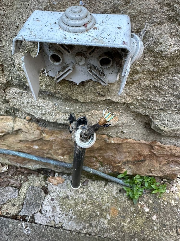

I could not find any other extensions. I see two cables going into the house, it seems like one of them is connected to the master socket and the other has been cut?
WhatsApp Image 2024-08-16 at 15.06.49.jpegWhatsApp Image 2024-08-16 at 15.04.20.jpegWhatsApp Image 2024-08-16 at 15.09.34.jpeg

@MisterW all done.

Wow that’s better, The increase in SNR shows that there is now headroom for the DLM to automatically increase your speed. If you can live with the hub at this location then chop off the extension wiring and replace the faceplate. The trick now is to get it set up and then leave it alone for a week or so to see if your speed slowly improves.
If you have a landline and want to use the extension for that then you need to fit a filtered faceplate just for phones.
