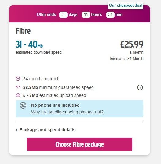

Hello,
plusnet had 66-72 available speed on my property, which I switched to (activating on the 21st of August) , due to BT not having that speed. I have spoke to openreach several times and they found an issue which they fixed and said I should be able to get 80mbps now, which I raised to BT and were not able to assist.
While I was very happy with BT for years, their migration to EE's customer service has caused a lot of issues for me in terms of communication and who to speak to.
On plusnet currently, it does not show the speed I ordered available anymore for my property. I am unable to figure out what speed I will be getting once it is live, I don't want to change providers if it is going to stay the same. I've attached the photo of the speed I ordered.

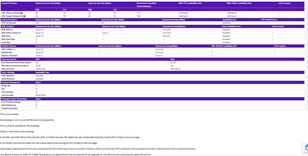

@MrEkeis Looking at the Availability Checker you posted, it appears your Fibre cabinet has no spare ports - hence the 'Waiting List' comment. but as you already have a fibre connection, your move to PN should still proceed - it merely requires a change (in the cab, I believe) to move you.

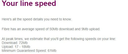

Would it be possible to see what speed I will be getting from plusnet? The speed online has changed from the above photo, to the blow.

As you will be moving to a SOGEA (no phone component) package, and going on the details in that availability checker, you are extremely close to your cabinet, and should, therefore, get the speeds advised initially, or even better.
The PN 'guess my speed' system appears to have a mind of its own, and gives variations which bear little resemblance to reality. Which Hub/router do you currently have, as information from that may help me (or others) to give you a slightly more sensible answer?

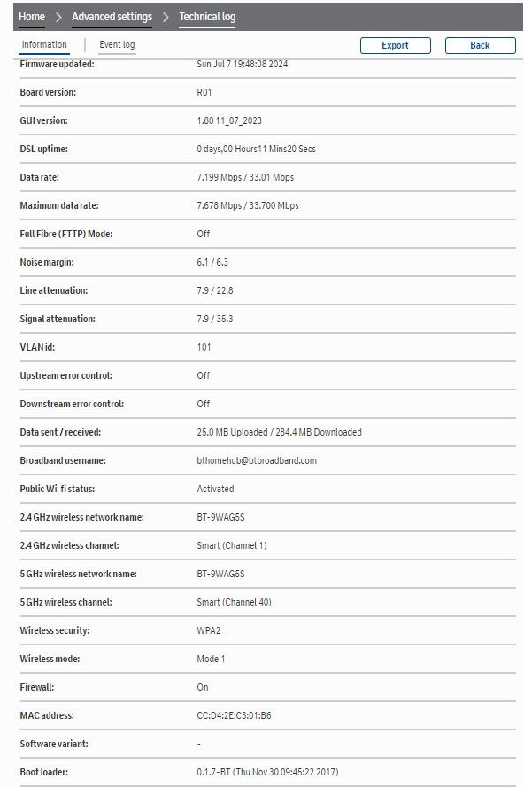

It isn't a 'hardware' issue, the reason I asked for your hub details was to find out which 'page' on there would give us an idea of your possibilities re speed. As you have a BT SH2, although I have no direct experience of them, but understand they resemble a PN Hub2, is there any chance of you posting a screenshot of the page on there which resembles this:
Please edit your reply to ensure you post no personal details

@MrEkeis Thank you. I am now going to get my lunch, and then I'll be out for a while, so just a quick comment. The attenuation figures in that screenshot suggest to me that you are further away from your fibre cab than the BTw checker suggests, so I suspect you may have a problem hitting the high values suggested on there.
Maybe @MisterW  or @corringham would like to comment, and correct any misconceptions I may have?

That's really not good!
Either there's still a fault present on the line or the BT wholesale estimates are wrong!
Maybe there's some aluminium cables in there...

@MisterW Given the DSL uptime, I suspect a fault?

Hadn't looked at that, got as far as the speeds and SNR figures. I had expected that if a previous fault had been fixed , that the line may still be banded and thus the SNR would be elevated.
@MrEkeis what type of BT master socket do you have ?
do you have any internal extension wiring ? and is your router connected to the master socket ?
