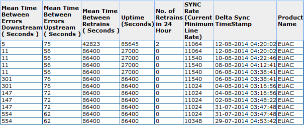

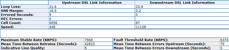

What I think would be useful is if we can get one of the Plusnet CRT to post up your broadband DLM (exchange) data and a graphical Radius log - that details you connections to Plusnet's network.
Posts: 5,369
Registered: 13-07-2012
Re: Broadband problem?
Hi Jon,
I've ran a few checks on your line and not detected any obvious issues.
Your line has been stable the majority of the time, although this morning you've had several disconnections, have you initiated these?
<img src="http://community.plus.net/visualradius/generated/image14079182398737.png"/>
Your line does have a very low SNR margin on the downstream as the target is set at 3dB, it's also probably worth us uncapping your upload speed if you're ok with that?
Your line is erroring at the minute fairly frequently which has caused the DLM to turn interleaving on, so it may be worth seeing if that helps over the coming days.
