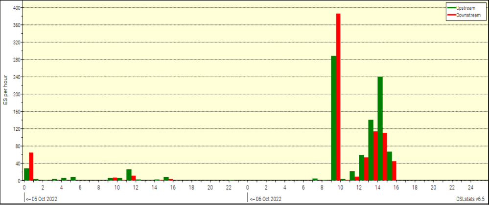

I've attached my broadband performance over the last 24hrs below for reference, the prior day was similar. In 48hrs there have been 13 disconnects, increasing.

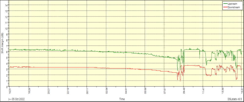

Looking at that SNR plot, it could be either a phone line or broadband issue - is your phone line clear - dial 17070 and select option 2 - there should be silence apart from the regular 'Quiet Line Test' message?

Yes, the phone line crackles too, so to me points towards a copper cable fault affecting both voice and broadband. We had something similar a couple of years ago which Openreach fixed, turned out to be an underground cable issue back then. As mentioned earlier, I'm now using the "test socket" to rule out issues on myside.

Another bad period, the line fault seems pretty regular now as the SNR plot indicates, even though I'm now back on a 6dB profile (was 3dB), no surprise there though ☹️. Disconnect count gone up to 20. Hoping this can get sorted out soon as streaming is now unreliable. @Gandalf , last time we "spoke" you said to come back to you if any further problems, what are you thoughts on this please?

If your phone line's crackling then we'd ought to get that looked at first as it's likely your broadband will settle down once it's fixed. I've tested your line and the tests aren't showing the cause for the noise, so we'd need to arrange an engineer visit to investigate further. Are you home any days from Tuesday next week?
