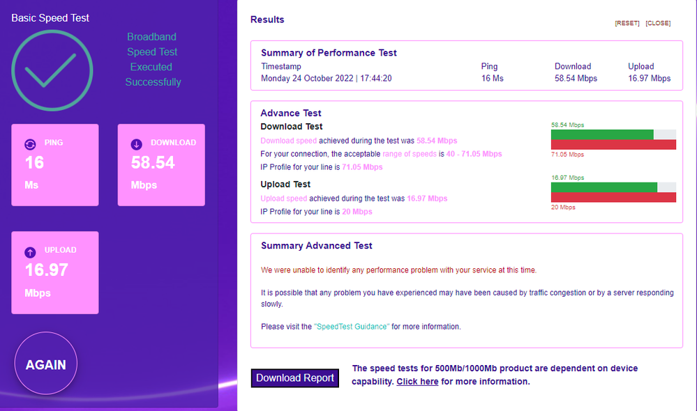

@ally153 Can you post a screenshot of the 'Additional Diagnostic' - found after running https://speedtest.btwholesale.com/
ally153
Posts: 11
Registered: ‎14-11-2021
Re: Big difference between actual download rate vs attainable
Posts: 22,751
Thanks: 7,955
Fixes: 334
Thanks for that - so your Plusnet profile is set to 71.05Mbps, and won't be the cause of restrictions, so something else is the cause.

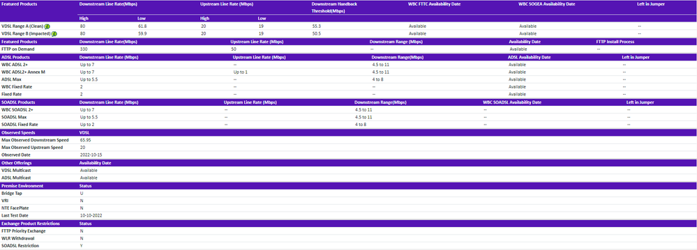

Sorry for asking for more detail, but as your modem/router does not make it easy to find the information, one other (maybe) helpful report is:https://www.broadbandchecker.btwholesale.com/#/ADSL -obscure your phone number, though.
ally153
Posts: 11
Posts: 22,751
Thanks: 7,955
Fixes: 334
OK - that tells us the speed to your test socket was ~ 65 (a week ago), but I have just noticed on the router details that your D/S SNR looks a little high - how far are are you from the green cabinet?
