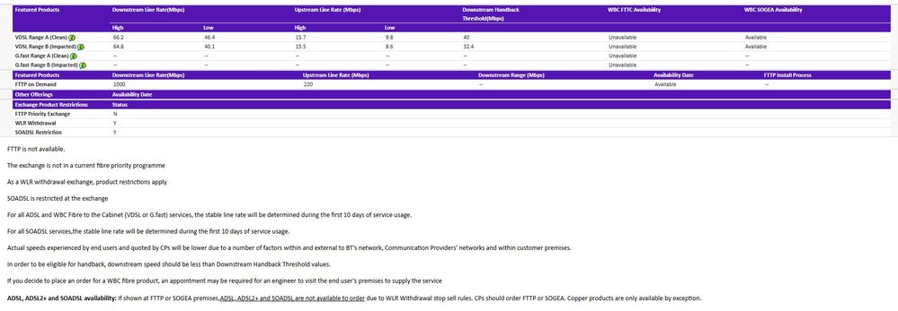

@Spangles What does https://www.broadbandchecker.btwholesale.com/#/ADSL/AddressHome say for your address - a screenshot, hiding your address, attached to a post, would help us to offer advice.

Re: All my neighbours are offered faster internet packages
Top is my address, bottom is my neighbour's (we share a wall)
Thanks - I'll need to get those shots released, so will be back as soon as possible.
There you go...
