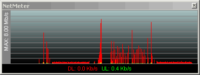

In fact, not only is the most recent traffic management problem most definitely NOT FIXED despite service.status claims to the contrary, it is actually significantly worse tonight than it has been earlier in the week ... and it was way bad enough then !!!
Streaming media (and 4oD in particular) is 100% unusable tonight as opposed to most things being around 90% unusable for significant periods of time as they have been since the problem first started.  As per bleedin' usual, this problem very much appears to be due solely to PN quite unreasonably and totally unjustifiably throttling AKAMAI traffic to near zero data transfer rates for some (but not necessarily all) users Sad Sad Sad
The following netmeter graph demonstrates and positively confirms the problem occurring right now:
Do you see that tiny weeny little line showing data transfer at sub dial-up speeds ? Well that's Akamai streaming video data for 4oD programmes, all 4oD programmes that I've tried.  The other somewhat more reasonable looking data transfer is for certain adverts and general web traffic etc.  In addition to this, some adverts from some other Ad houses and/or media hosts are simply not working at all so there is either just a great long pause of nothingness where the relevant Ad servers should be sending data or the expected adverts are missing completely.
Streaming data in general (and 40D in particular) has once again been virtually unusable ever since this repeat performance of previous remarkably similar problems occurred.  Somewhere around 2 seconds of video followed by around10 secs of buffering (repeated ad infinitum for ALL programmes tried) tends to somewhat spoil the overall viewing experience and all that Angry

The Akamai server used above was "b.scorecardresearch.com" [84.53.138.27 or 84.53.138.32] AKA "a1294.w20.akamai.net"
PLEASE ALSO NOTE before adding "everything is working perfectly OK for me" stylee comments that some users may be fortunate enough to not be suffering with the latest problem(s) and in addition, some 4oD programmes being streamed to some users may also be being served from totally different sources. Just because everything is working for you doesn't mean that it's working for everyone else Smiley

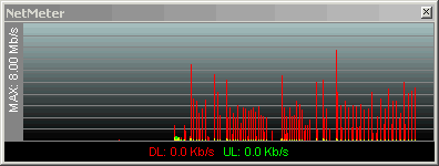

Well guess what ... yup, it's now just after midnight and 4oD is making a halfway reasonable attempt at working  Roll eyes  HOWEVER, performance is still poor even compared to what I would consider as 'normal' relatively poor performance when using PN.
No further changes in gateway or indeed anything else whatsoever from earlier on but exactly the same programme streaming now looks like this:
Still pretty poor really with significantly lower BW than is usual for PN and not even remotely close to what is actually appropriate for my connection when downloading data from Akamai servers of course.
