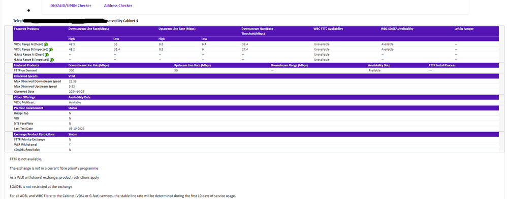

Can you post a screenshot of this link, but obscure your phone number. BT Broadband

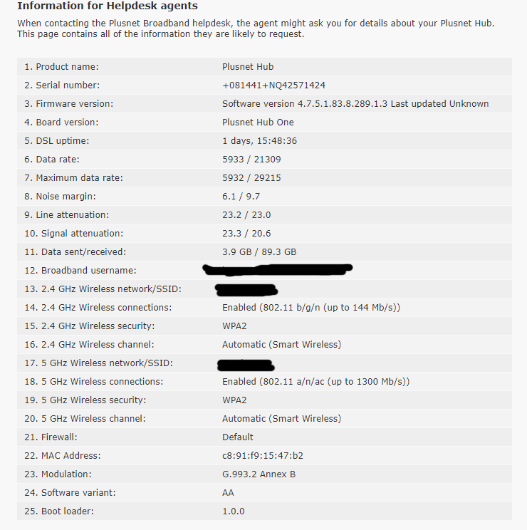

@hunter27 From that, I get a suspicion. Can you provide a screenshot of your Helpdesk (Hub1) , or Technical Log - Information,  (Hub2)obscuring personal details?

Cheers, @hunter27 . You have a fault somewhere. Please follow the below:

I can assure you there is a fault - your downstream signal to noise ratio is too high, and, unless you have intentionally turned off the router, your uptime is too low.
I'll await further developments.

Thanks, Pete. I suggest you text 'ADVISOR' tomorrow and explain to them that you have had a recent DSL drop - as shown in the Helpdesk picture posted earlier, and that your SNR is elevated, which together indicate a fault in the Openreach network, most likely.
