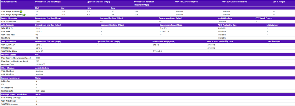

My download sync is very close to the maximum attainable according to the BT Wholesale Checker however my upload sync is less than half at 2.5mbps. Is there an upload sync cap?

Apologies my subject may have been misleading. This is what BT Checker says, I am wondering why our upload is below the low estimate when our download is basically inline with the high estimate. I had assumed there would be some level of relationship between the two speeds. If we are getting good download why do we get bad upload.

Ok, so you are on a FTTC product with Plusnet, presumably Fibre Unlimited.  With those estimates, you'll be quite a way from the Cabinet.
The first thing I'd try is connecting your router to the test socket, behind the face plate of your Master Socket, and then post a screenshot of your connection stats from your router.
What router are you using?  Is it one of the Plusnet Hubs? If so the stats we're after will be on the Helpdesk page which, if I remember correctly, are somewhere in the Advanced section.  I've not got my HubTwo connected at the moment, but I'm sure someone will be able to give the exact location if needed.  If posting a screenshot I suggest blanking out the username on the image.
