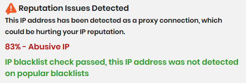

@doug1
I just checked your IP here https://www.ipqualityscore.com/ip-reputation-check/lookup/212.56.108.219
Not good news, it may not just be your IP but others in the same network range
EDIT But https://www.liveipmap.com/  is happy

Re: 403 error https://bt.centercode.com from my Plusnet
@Dan_the_Van  I've just checked my IP address against the IP quality score, the results are not good....
Before @doug1 gets seriously paranoid has anybody here got a good score ?
Posts: 4,292
Thanks: 3,272
@Champnet
I do 80.229.xxx.xxx
I have checked others and it's all a bit random which address pass or not.
I might consider a browser based VPN to bypass the issue
EDIT:
I get similar proxy/VPN warnings on my IPV6 connection result, and I know it isn't a proxy, and I don't use a VPN, so IPQS itself appears suspect.
Posts: 4,292
Thanks: 3,272
I just posted the link which had a negative result, the paranoia would be self induced. I did mention another site which showed no issue with @doug1 IP Address. https://www.abuseipdb.com/ also does not find an issue
Bit like reading the newspapers, you make your own judgement on the story being read, if necessary do your own research.
"This IP address had been detected as a proxy connection"
I wonder what that actually means ?
If it is saying that the tested IP address is on a known list of VPNs, tunnels (such as '6in4'), etc, then that's one thing.
Or is it saying that some proxy like behaviour has been detected between the user's browser and the testing server ?
'proxy like behaviour' *could* be caused by a user's browser extensions, OS anti-virus, ad-blocking, router caching, etc.
When my connection was much slower, I used to use 'squid' as a caching proxy in my router to hugely improve my broadband's perceived download speed, BUT Netflix (only) refused to work because they could detect something between them and my browser. When I disabled the router's caching proxy, then the Netflix VPN/Proxy blocked screen disappeared.
