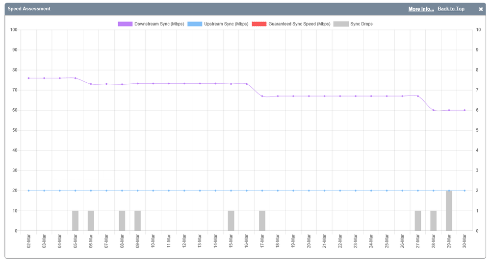

In this case, the banding appears to be a symptom, of recent disconnections on the line, I'll pop a graph below which shows them, and how they've resulted in a gradual drop in sync speed.
A KBD has detected a Bridge Tap, which is usually found when there are defects with the wiring both in and around the property's perimeter.

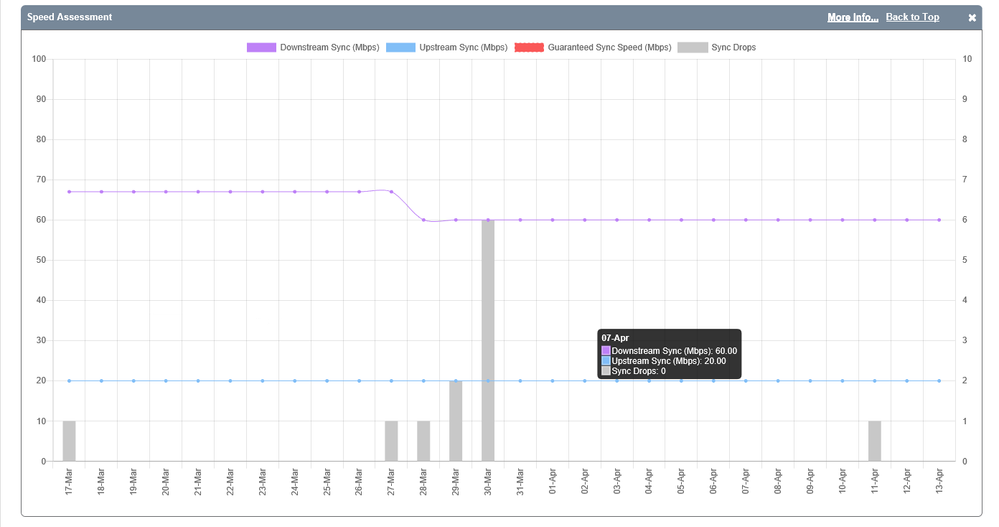

Thanks a lot for getting back in touch @suplex and for your continued patience while we monitor your connection. It's paid off, check the graph out below which shows just one disconnection over the last few days, so we're now at a point where we can raise a DLM reset.
That's now been done, so you should see your speed jump back up to where it used to be within the next 3-5 working days.
