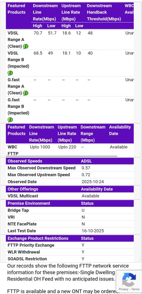

While hiding any personal details can you post a screen image of the results from the following Checker
Re: 0.392Mb Minimum guaranteed speed!
25-10-2025 7:38 PM
Attached thanks
25-10-2025 7:47 PM
Are you able to post the router line stats please? Sync speeds and SNRM.
This looks like ADSL with a fault. Is there a dial tone on the line?

And FTTP is available.
25-10-2025 8:38 PM
Thanks for the image.
Full Fibre is available so that would sort any speed issues. It would mean losing the landline if this matters.
Not only available, but its a Fibre priority exchange and so any change of Product or ISP must be to Full Fibre(FTTP)
