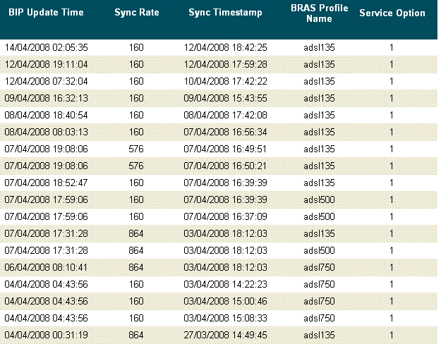

I've had a look at your profiles on BTs tool and it's been up and down for a week or so - I've attached a screenshot. I'd say there's something there causing intermittent connectivity or at least noise spikes, would you be able to confirm this and hopefully also test the connection with the router plugged into the master socket?

The above link may help to identify why you suffer from speed fluctuations periodically.  Basically, you have suffered what is commonly referred to as a sync blip.  What this means is that your modem or router has lost the synchronisation or signal that it holds with the exchange and has then reconnected.  When it has reconnected, it has done this at a massively lower speed, which causes the BT profile to drop within 75 minutes.  This profile dropped to 135Kbps.
Unfortunately, whilst profile drops will happen within 75 minutes, it will generally take about 3 days for it to pick up again.  Looking at your line, you're now seeing a synchronisation speed of 5792Kbps, which should result in your profile picking up to 5000Kbps, but this will probably not happen until the 17th.  It is of course possible that this will happen before then, but generally it will take 3 days.
