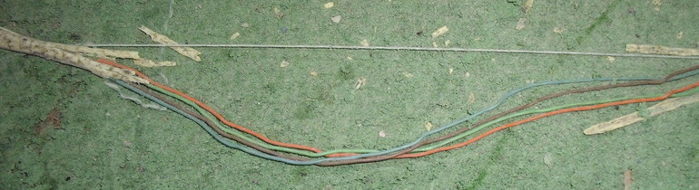

paul12pn
Posts: 15
Registered: ‎26-06-2012
Re: Junction Box to BT Master Socket Cable
Here's a picture of the frayed wiring. I've had to crop some of the top and bottom of the photo to bring the file size down.
adamwalker
Posts: 16,872
Thanks: 882
Fixes: 221
Registered: ‎27-04-2007
yep, I'd definitely get that looked at Smiley

Anotherone
Champion
Posts: 19,107
Thanks: 457
Fixes: 21
Registered: ‎31-08-2007
@Adam
Even though that is the cable to the Master socket, are you aware of cases where OpenReach have repaired such damage without presenting the user with a bill when the damage has been caused by the cable being under a carpet?
jojopillo
Posts: 9,786
Registered: ‎16-06-2010
I imagine they would have to conclude that the original wiring was fitted by an OR engineer, so if it was under a carpet it would have been put there by them Smiley
