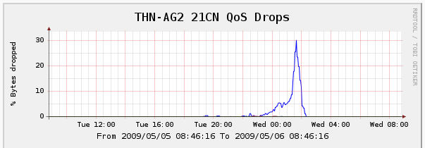

can hardly hear my m8 on XBL and all cars in race pro are lagging to the point i cant play
somthing needs doing asap on this one as i am being out performed by a sky connection.
this dosent look gd on you PN
EDIT
thanks pn no gaming for me tonight. just went down to tell my m8 what i was pinging at and he couldnt even hear me i had to send him a private message just so he could her me being very unhappy with PN at the mo and that i wouldnt be back on tonight unless my pings come back down to below at least 50ms
also not over the moon that you didnt reply to post 78 and 79 today all i asked for was a update on the situation after having to put up all bank hols with this issue and the previous week before that gathering the evidence that said it was PN's network at fault.
are PN actualy closely montoring 21cn as i am very surrpised that your self's did not pick up that the queues where upside down and pings through the roof before i did and there is no service status here about the issue http://community.plus.net/21cn-maintenance/ or on the standard service status page
this also seems to have been made worse by the increase in bandwidth given to the sliver queue

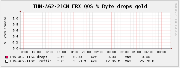

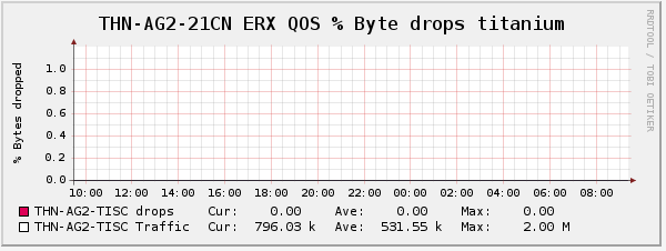

Quote from: ASBO are PN actualy closely montoring 21cn as i am very surrpised that your self's did not pick up that the queues where upside down and pings through the roof before i did and there is no service status here about the issue http://community.plus.net/21cn-maintenance/ or on the standard service status page.
Sorry about this, I'll look to get something posted this morning. I'll also give those looking into the 21CN issues a prod (ref:56389). The graphing we recently set up does not look particularly pretty at all for last night
Edit: Looks like I might have misinterpreted that graphing which is for *all* drops across all queues. If you look at the Gold/Titanium graphs things look much more favourable:
