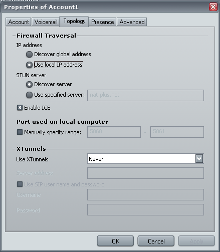

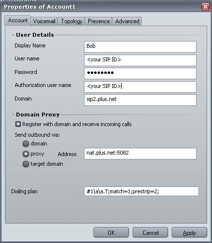

Seeing as we'll not be migrating any customers across until next week, I'll start the ball rolling...
X-Lite Version 3 build 41150: (Windows)

I have configured X-lite as per the VOIP Beta trial instructions and can make O/G calls to UK landlines OK. If I call the regional phone number the call setup is successful but the transmission is I/C only with the calling number unable to hear. I tried Bobs config but then nothing works. I have disabled Vista firewall and (with help) tried a variety of settings on my Netgear router. Router is DG834N with latest software. Any thoughts please  Huh?
Took advice about reverting to x-lite 2 and my transmission problems solved! Grin

We have just figured out an interesting thing about the problem on Xlite, whereby there is no outbound audio on inbound non sip calls. If you press and unpress the 'hold' button in the software, two way audio is restored and the rest of the call is fine.  Roll Eyes
I have been able to replicate this in X-lite, but it's not a problem that occurs in any of the other clients or hardware phones I have tried today. As such, it looks like it may be a very odd bug, and I think it's more likely to be an issue with X-lite then it is with the new Voip service.
So far the best word we have found to describe this is: Random. If anyone has any ideas, we'd love to hear them!

Does look like X-lite, there's a similar thread over on the X-lite support forum here from someone using Sipgate.

An update from Gradwell re: audio issues
"we believe this issue is with the xlite software. It appears that the latest version release has actually broken a number of things.
I am performing some investigations for you, and will keep this ticket open. In the mean time, I would suggest using an older version of xlite."
My suggestion is to go to this link and download v2 (older version) of xlite - worked first time for me
